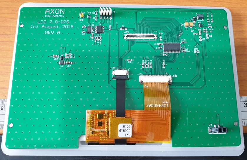

We have developed an IPS LCD for our Nano PC T3 Plus based data loggers to give us a sunlight-readable display. It all works because we have hacked uboot and the kernel to select this display.
We have asked FriendlyArm for a special version of their STM8 software with a unique ID that we can use to detect the LCD when it powers up and the uboot searches for it on 1-wire but they have so far failed to reply to our email requests for this with just one email saying that the source was closed. We have asked them to only supply us with a HEX file with this unique ID that we can encode the LCD with. We have even sent them the code for uboot and the kernel along with the schematic for our LCD design as a goodwill gesture. The attached images show the display in the prototype carrier. It is designed as a drop-in replacement for the HD702.
Because of their lack of proper customer support, we are stuck just now with hacking the code which means we can't use the same build with the other loggers that use the standard HD702 LCD. :(
