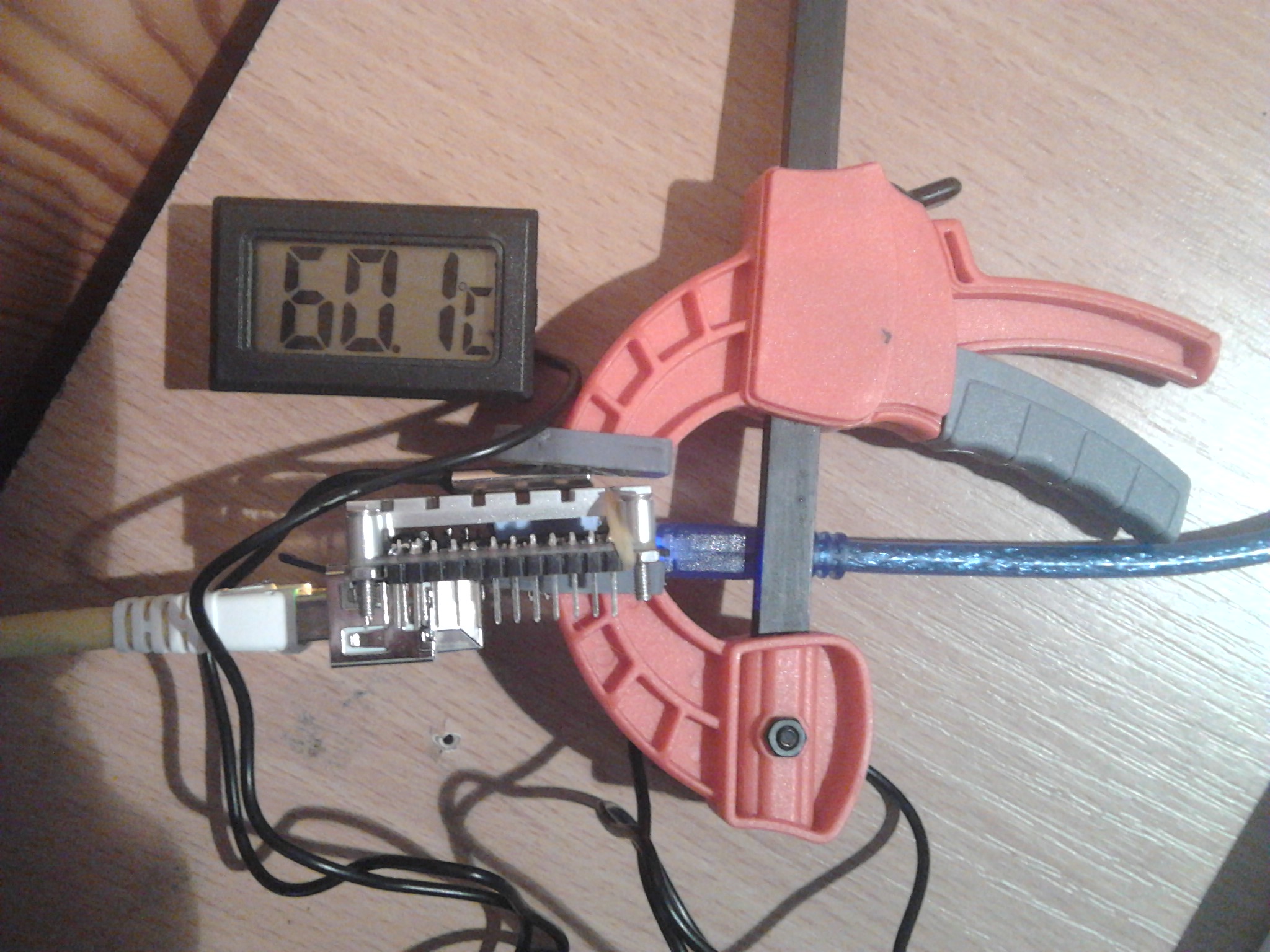

Digital thermometer arrived today, and I did some measurements.
In order to have same conditions for measurements I clamped the thermometer on the heatsink just above the thermal paste:
The measurements show increasing differences between CPU temperature measured by "cpu_freq" command and thermometer:
43 40.1
61 50.3
73 56.8
80 58.9
So either the thermometer is not connected good enough, or really the thermal paste from Friendlyarm is poor.
So I did measure again with my 2nd Nanopi Neo, thermometer clamped diagonally directly on H3 CPU:
There are differences as well compared to "cpu_freq" output (left), but not that big:
57 54.5
76 68.5
83 69.1
These measurements seem to confirm that the heatsink has a considerable lower temperature than the CPU which show poor thermal transfer of the thermal paste. Perhaps Friendlyarm did not test whether the thermal paset they sell is good enough?
Hermann.
