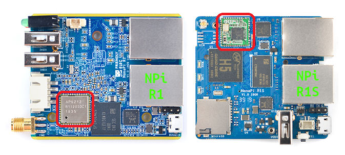

[Q] NanoPi R1S has which Realtek WiFi Chipset?
Because the pictures are very small, I cant see the number of the Realtek Wifi-Module chipset.

AP6212 Module
sami wrote:
AP6212 Module
Nope ;) the AP6212 is on the NanoPi R1 only - the NanoPi R1S has a Realtek-Module on the picture
(see attached)
I got the H5. It seems to have this chip:
https://www.realtek.com/en/products/com ... /rtl8189es
  SysFS ID: /class/net/wlan0
  SysFS Device Link: /devices/platform/soc/1c10000.mmc/mmc_host/mmc2/mmc2:0001/mmc2:0001:1
  Hardware Class: network interface
  Model: "WLAN network interface"
  Driver: "rtl8189es"
  Device File: wlan0
  HW Address: <mac here>
  Config Status: cfg=new, avail=yes, need=no, active=unknown
The NanoPi R1S has a Realtek-Module on the picture.
