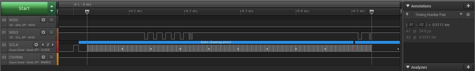

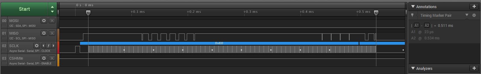

I'm trying to comunicate with an SPI device on a NanoPi Neo core 2 (SPI0) but i have some problems.
I can't connect the CS signal and I have a strange first clock pulse so the device receive wrong data
As you can see the
Any comments/ suggestions are welcome

AFAIK SPI works as expected. Which kernel you use?
If you don't capture the SPI when your CS is low, you are probably reading other SPI activitiy on the bus.
You need to setup your logic analyser to trigger capture when your CS goes low.
