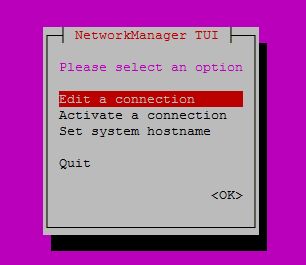

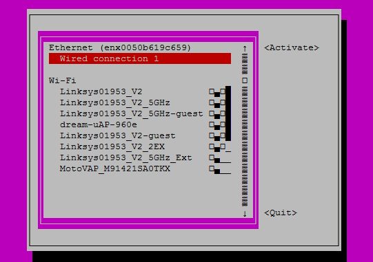

Not sure what got my WiFi working but it's working now and my /etc/wpa_supplicant/wpa_supplicant.conf file looks like this with my WiFi password x out.
auto wlan0
iface wlan0 inet dhcp
wpa-ssid Linksys01953_V2
wpa-psk xxxxxxxxxxxxxxxxxxxxxxxx
It works.
Not real sure if this is what got it working because a lot of times I did a dhclient wlan0 and waited and then did ifconfig to see if it got a IP but it never did till I did a reboot.
So did a lot of editing things and not sure what worked.
To bad I did not reboot after every edit.
Here is my /etc/network/interfaces
auto lo
iface lo inet loopback
iface eth0 inet dhcp
allow-hotplug wlan0
auto wlan0
wpa-ssid "Linksys01953_V2"
wpa-psk "xxxxxxxxxxxxxxxxxxxxxxxx"
Not sure what one got it working with WiFi.
-Raymond Day
Used a DD command to copy the image to the eMMC so I had to start over. This time I found out what get's it on WiFi.
The /etc/network/interfaces file. I just did a cp /etc/network/interfaces /etc/network/interfaces~
Then vi /etc/network/interfaces and clear it all out what they have in there and copied a past the other post I put before this one.
nmtui easy command line WiFi.jpg (15.71 KiB) Viewed 33356 times
Got down one to Activate a connection and you see this at lest this is the WiFi mine picks up.
nmtui easy command line WiFi list.jpg (41.2 KiB) Viewed 33356 times
That would make it easy to set up WiFi and this nano pi air image should have that in it because besides RS-232 that is about the only way to connect to it.

Now that I have mine working good with room on the 8GB eMMC can install things. I installed the apt install network-manager Took a wile to install all it needed. But it worked.
After installing it had to start it.
service NetworkManager start
But go to activate and it's all blank on it's WiFi.
Rebooted and still did not fix it. I guess that's why they did not install it. Even the change hostname don't work on it. Just says did not change it.
-Raymond Day
-Raymond Day
Multi-manager will confuse the wifi configuration. That's why we don't install others networking setting tools.
That's because network-manager gracefully ignores all interfaces defined the old/anachronistic way in /etc/network/interfaces.
Armbian for NanoPi Air ships with an empty /etc/network/interfaces and a serial console on the Micro USB port so you're up and running within 1 minute after booting due to nmtui making access to your network easy (no annoying wpa_supplicant stuff). Some performance numbers for some SBC: https://forum.armbian.com/index.php?/to ... es-on-sbc/
