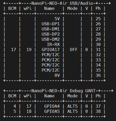

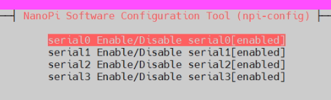

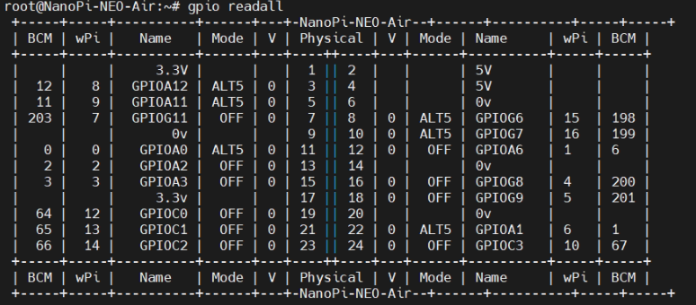

I have a problem to set up the UART1 ttyS1 on NanoPi NEO Air-LTS
I want to use the tiny Neo Air Module with both serial ports for an Dula (W)M-Bus Module from Solvimus
Is there a correct layout for the PINs and the way to config the Overlay and somthing else to get it work
I try since days to config and do loop-tests on UART1 ttyS1 and it‘s not working
I do a loopback an the serial port UART1 ttyS1 and UART2 ttyS2, UART2 ttyS2 is working, UART1 ttyS1 is not working. I think there is another service bound to the UART1 ttyS1.

uEnv.txt
# General options
ramdisk=rootfs.cpio.gz
kernel=zImage
fix_addr 0x44500000
kernel_addr=0x46000000
ramdisk_addr=0x47000000
dtb_addr=0x48000000
debug_port=ttyS0,115200
fsck.repair=yes
# 0 = /dev/fb0, First framebuffer
# 1 = /dev/fb1, Second framebuffer
# README: linux/Documentation/fb/fbcon.txt
fbcon=map:0
# Overlay options
# README: /overlays/README.txt
#uart0/enable=no
uart1/enable=yes
#uart2/enable=no
#uart3/enable=no
#i2c0/enable=no
#i2c1/enable=no
#i2c2/enable=no
#spi0/enable=no
#pwm0/enable=no
#ir/enable=no
#tft28/enable=no
#tft28/speed=50000000
#tft28/rotate=90
#tft28/fps=33
#tft28/debug=0x0
#tft13/enable=no
#tft13/speed=50000000
#tft13/rotate=0
#tft13/fps=0x0
#tft13/debug=0x0
