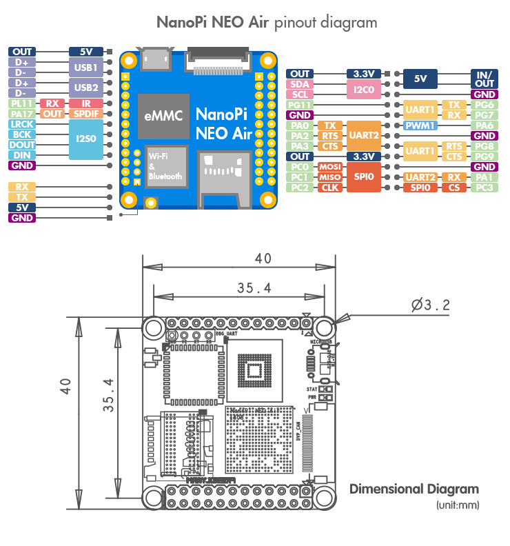

According to the schematic, I think the four solder pads near the camera interface are mic in and line out. Does anyone know the pin assignment?
Thanks a lot.
NanoPi NEO Air has no sound card and microphone pin.
Thanks!
In this thread: https://forum.armbian.com/index.php?/to ... audio-out/ it is shown to actually have pads for this, and a user mentions it to be working. However soldering those seems a pain...

Hi
You can see this picture
https://img.alicdn.com/imgextra/i4/7329 ... 291228.jpg
