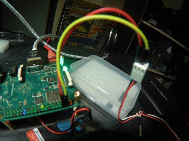

I ended up just going with this Fan. The price was good and it's really super quiet. It's not running off the T4 as intended, but it does keep things cool.
You can use this fan if you use jumber wires.
The black wire is negative, and the middle wire is positive.
Then connect negative wire to ground, and the positive to a 5V pin.
Like this.
