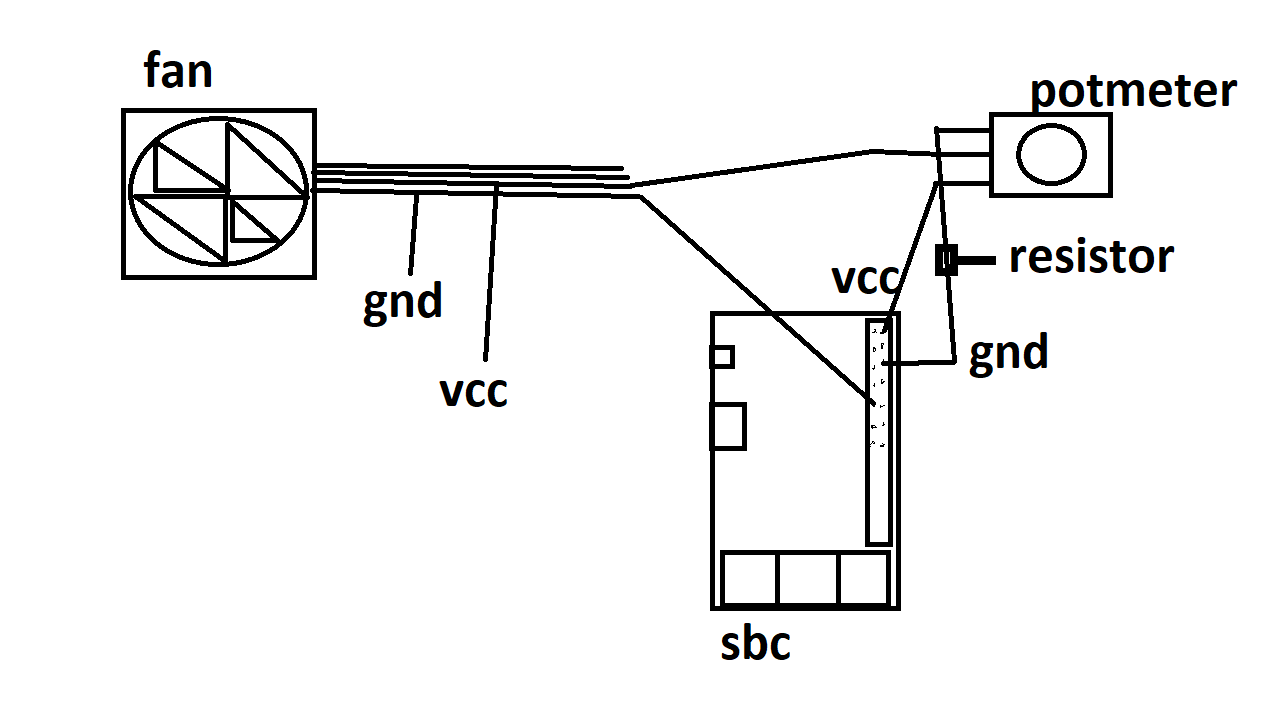

I need your help again regarding fan installation, because I want to add via gpio a PWM Noctua fan I bought, but I don't know how to do this.
Do I need to install something after connecting the fan?

That isn't as simple as pi. Is that Noctua fan 5V? What's the type? How many connections does it have?
I think it will have pwm, but it must be 5V to power it with the M4.
Here a good explenation on how to do this. 99% is the same for the M4
https://www.domoticz.com/wiki/Raspberry ... _with_bash
Or this seems a bit more simple
https://www.npmjs.com/package/rpi-fan-controller
Yes, the fan is a Noctua NF-A6x25 5V PWM https://noctua.at/en/nf-a6x25-5v-pwm/specification

Your fan is a 4-pin.
There`s a few things that could be a problem. Most of the M4 it`s GPIO`s are only 3V or 1.8V. Only the VDD is 5V.
I don`t know if it will work with 2 different voltages. Try it to see.
Here a good video that explains how to work with 4 pin fan.
https://www.youtube.com/watch?v=gKHww3qJbs8
What I see as an easy solution (for me) would be to use a microcontroller with a thermsistor. Put the thermistor on the heatsink an read the value. Then give the pwm with the microcontroller. You can power the microcontroller with 5V from the sbc, power the fan with 5V, and the pwm with the microcontroller. Enough room on that fan to put it on there.
Let me know how it goes, I haven`t done anything with the gpio`s of the M4.

AndreaN wrote:
At this regard I apologize if I haven't fully understood the thing, but somewhere I read that this shouldn't be done since it can cause serious damages to the board.
Is it true?
Yes and maybe it is true. I'm also no expert. But you could short your board if you do this wrong. it can't hurt the board to mix 5V with 3.3V to a common ground. But I don't think the fan will work properly. It depends on how the fan reads the pwm.
There is a way to do this safe and good, but again, it's not simple as pi ;)
You would need to make a circuit board, but I'm not sure of the components, and I can't find a good example.
What's imo much easier to do is put a pot meter in between the fan and the 5V gpio. Then you don't need the pwm to control the speed, but you have to turn it higher yourself when it's needed.
For this you MUST use a resistor or YOU WILL short/burn your board and potentiometer.
There are 3 pins on a pot meter, one end is ground, the other is vcc. The middle pin is where you would need to connect your vcc from your fan. Then ground from the fan also goes to a normal ground.
I've made a very pretty drawing of this.
You could then paste the pot meter to the fan so they're a whole.
But again, I'm also no expert. I'm a hobbyist who makes (a lot) mistakes himself.
