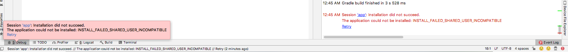

I followed the steps and I got this error:
INSTALL_FAILED_SHARED_USER_INCOMPATIBLE
Can you explain in more detail what you did?
Is that an output error from the build or something esle?
Sure. I followed the stepes, I geenerated the signed APK. But when I press debug, the application doesn't get installed and throws that error. Here is my source code:
