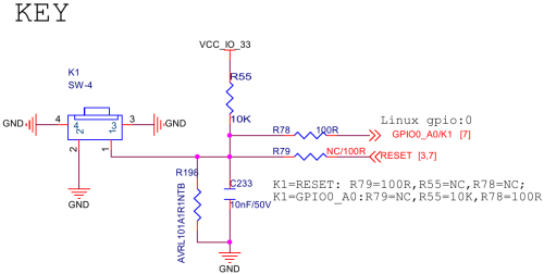

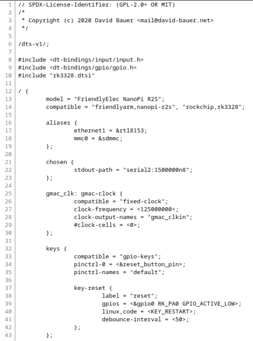

I got a brand new nanopi r2s, and noticed that the k1 reset button has no effect at all - is it purposeful? how can I add some functionality to it (i.e reset the device upon press)? would appreciate any lead.
Thanks a lot! Worked with the dts and now works properly
