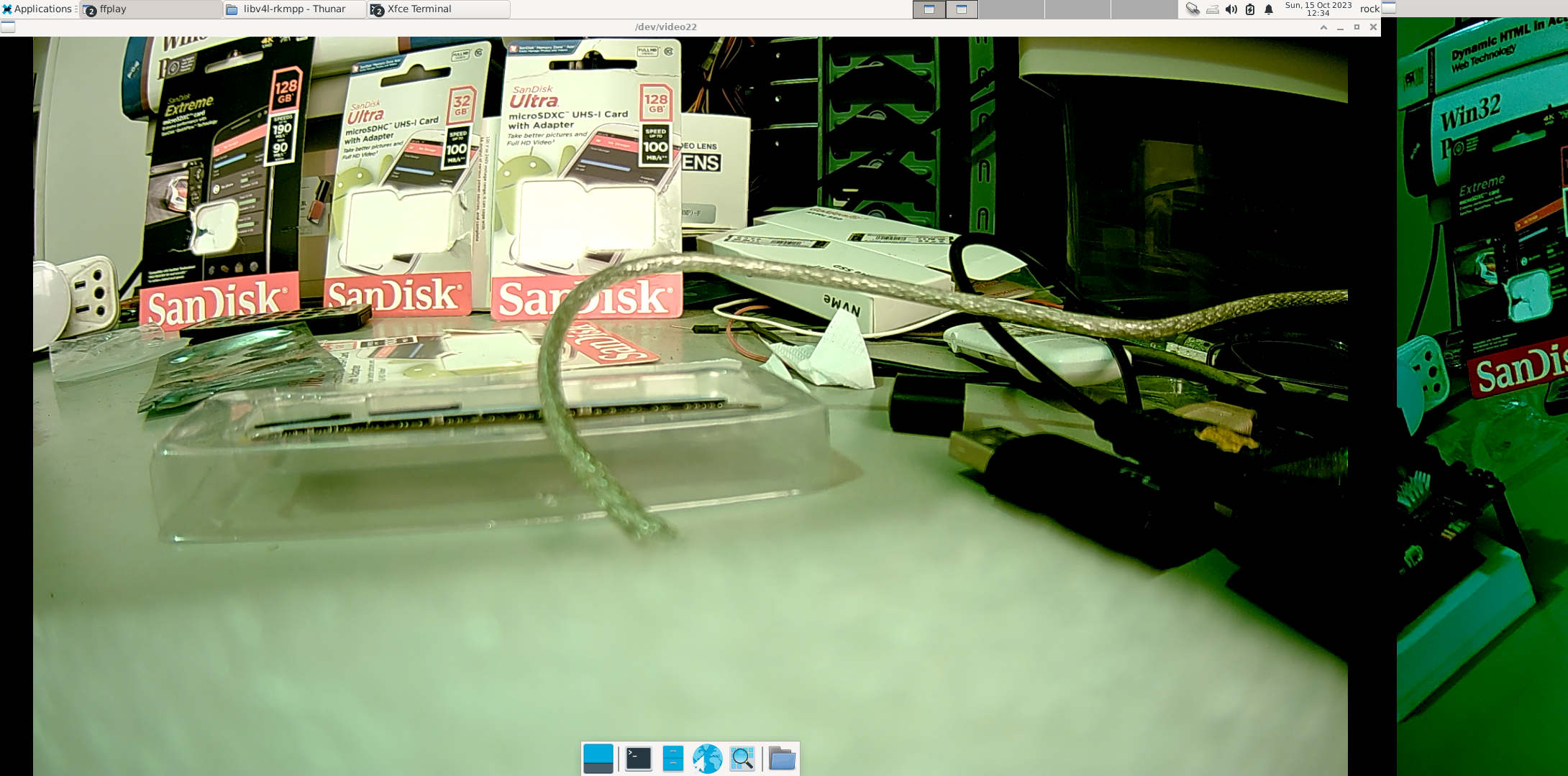

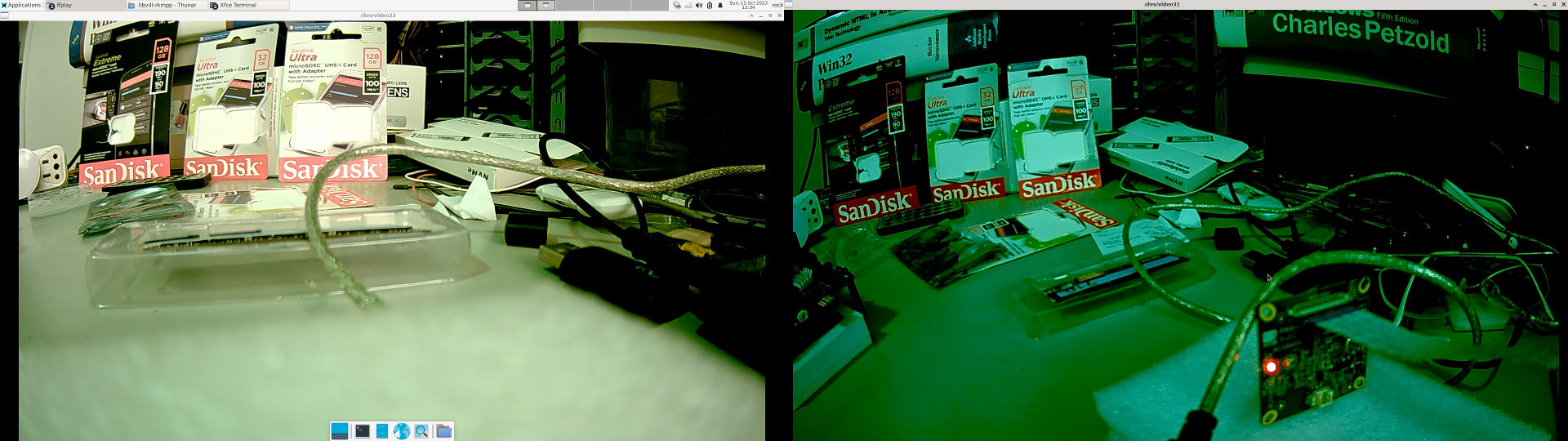

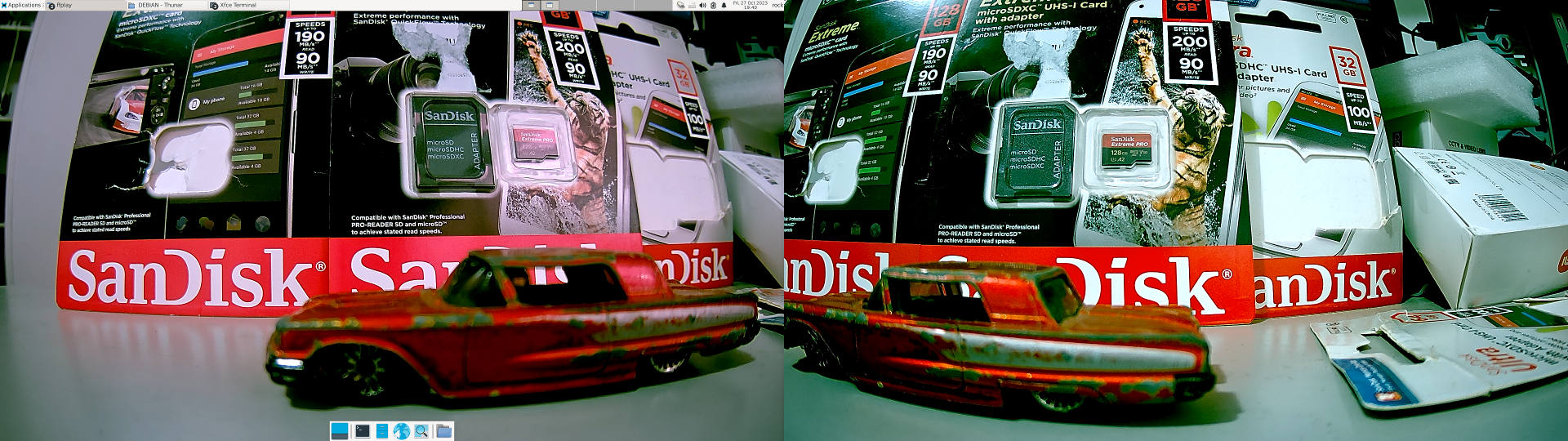

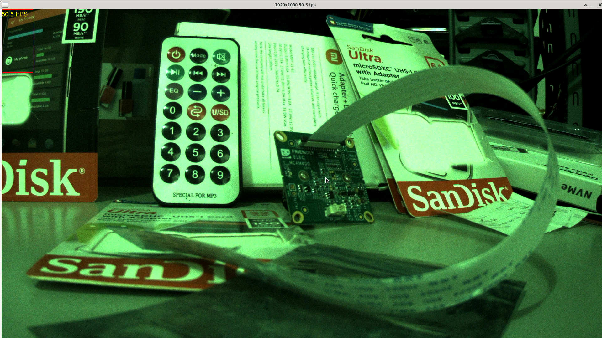

Now you can capture video from your camera. For example:
gst-launch-1.0 v4l2src device=/dev/video22 io-mode=4 ! video/x-raw,width=2688,height=1520,format=NV12,framerate=30/1 ! xvimagesink
Colors are not perfect, but at least you will be able to understand what is displayed by camera :)

Can you share some pictures? (to have an idea how is the image)

I just received the board and i was able to test and grab some images.
I rendered the frames at ~25 fps, so 3A is possibly capped at 30 fps. Maybe with libcamera one can have 120 fps, but I am not really sure if the driver can get 120 fps. I kept the original driver and added the 120 fps patch, maybe i did something wrong.
I was particularly interested in the dual-camera setup but the second camera image is dark and greenish, kind of.
i think FriendlyElec should invest in tuning the camera.
Here is what i get:
Camera 1 and Camera 2:
Fixed my 120 FPS mistake, I can't have other modes (or I couldn't find a way to set 120 FPS mode as the current mode).
Camera 2 ( CSI-1 sensor with IR filter), 120 FPS, rendering frames at ~50 FPS.
that's all folks.

By adjusting analog_gain and exposure we can get pretty nice images. see cam1 vs cam2 screenshot attached.
cam1 (left) : w/o IR filter (3.3 mm F2.2)
cam2 (right) : w IR filter (3.6 mm F2.0)
[code]"InitTimeValue": 0.03,
"InitGainValue": 8,
These values correspond to exposure 1399 and analogue_gain 1012[/code]
If i can understand how to balance analog_gain / exposure, it can be implemented in the capture program and then released the code, or we wait for the official tunning file.
