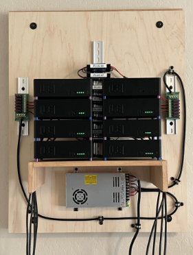

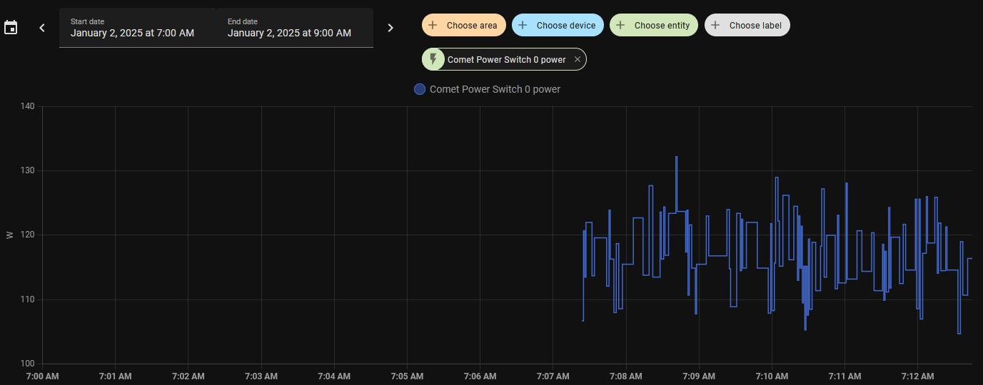

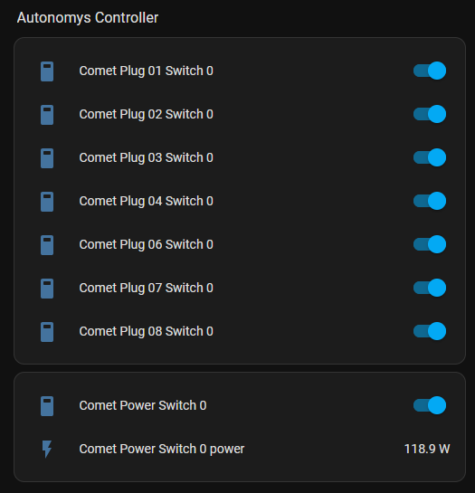

I've attached 2 photos showing the Home assistant integration to control 8 CM3588. I'm using these for a project called Autonomys (uses SSD/NVMEs to farm crypto) and 8 of these with 4x4TB NVMEs are only using between 118-130W which is really fantastic.
I have a Meanwell 350W PSU that provides 12v to 2 DIN rails with a distribution block. There is a DIN rail behind the CM3588s which have a 3d printed case for the Shelly switch and the WAGO connectors that are needed. Then from the Shelly switch I can simply plug them into the CM3588 barrel input. Super clean and easy.
