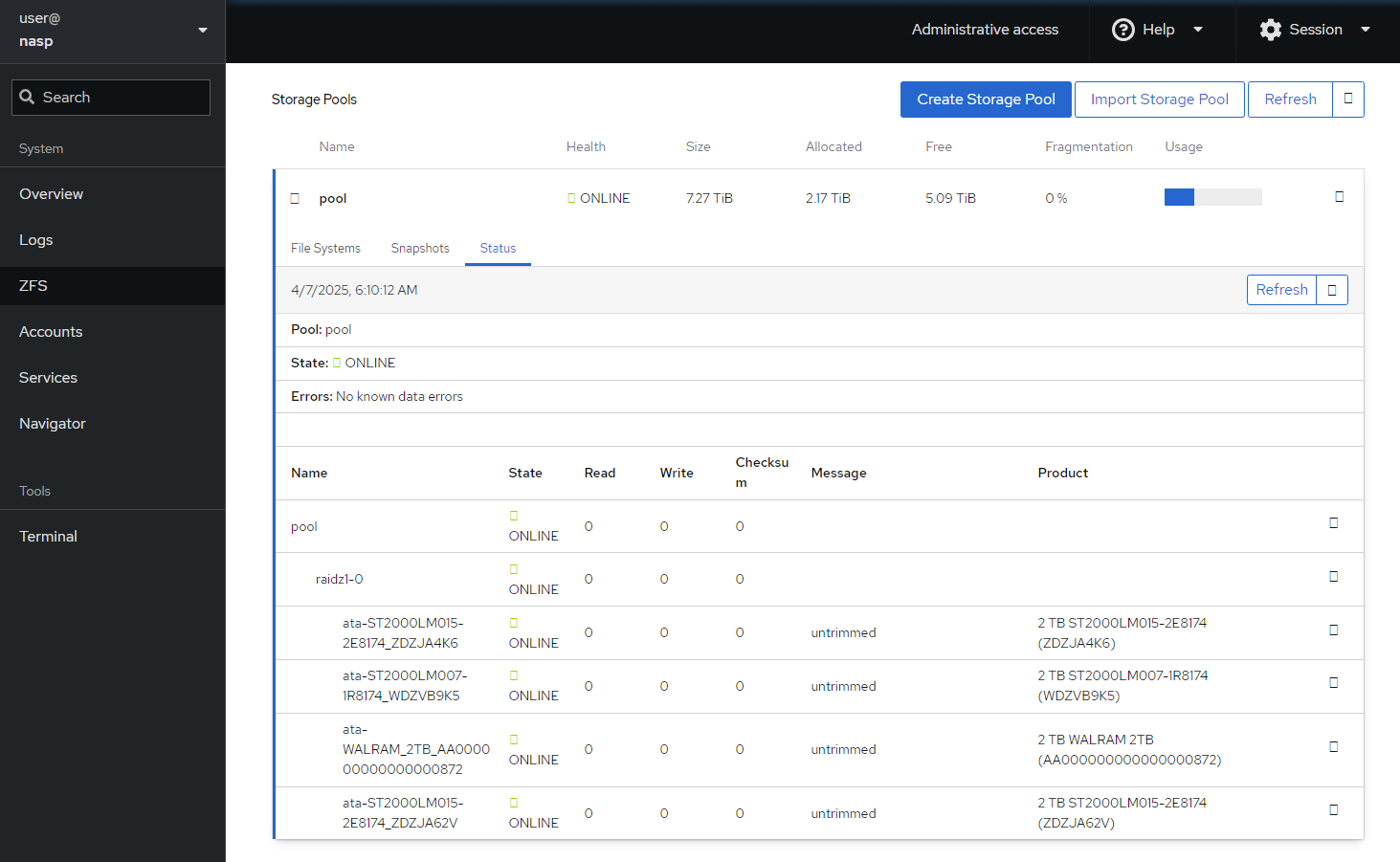

cockpit : ZFS full contol (ZFS status, Create ZFS Pool, mount, unmount, snapshot),:
Install cockpit If you need full control for ZFS to check and replace harddisk if failed use cockpit (after installing cockpit you can reach interface by http:ip address:9090
